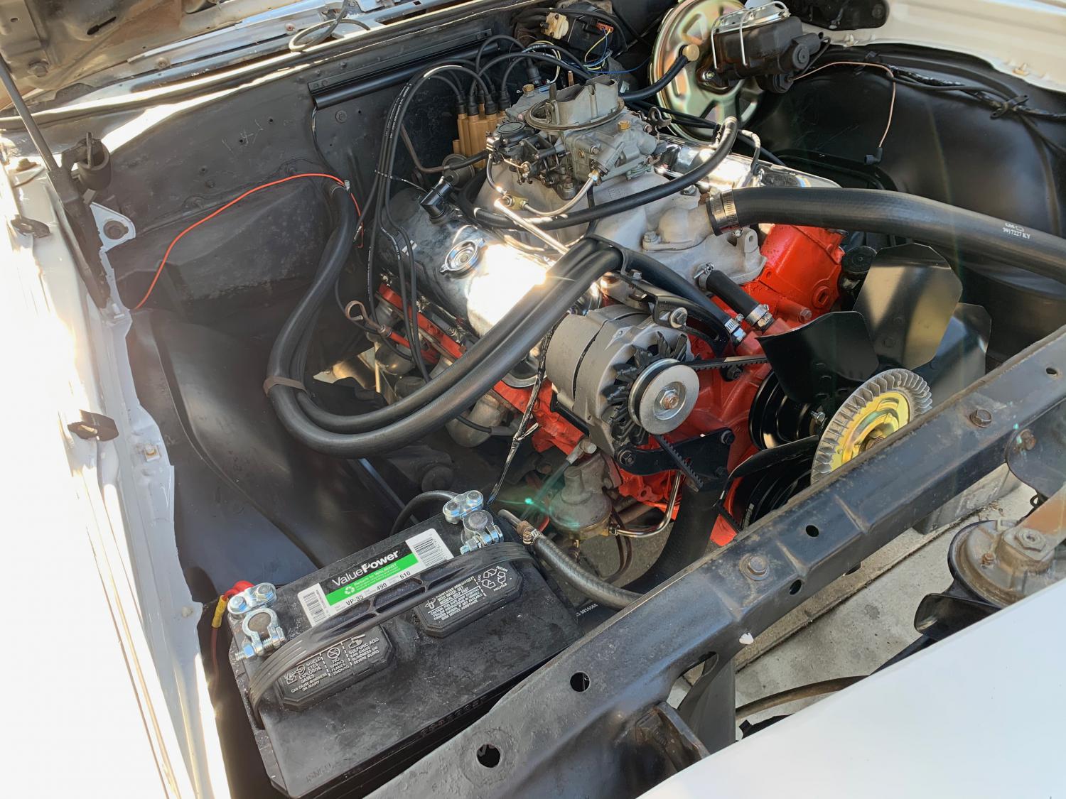

I never did get the pipe plug out of the cylinder head yesterday so I will work on that some more on another day, .... but here are a few pictures of the engine compartment
