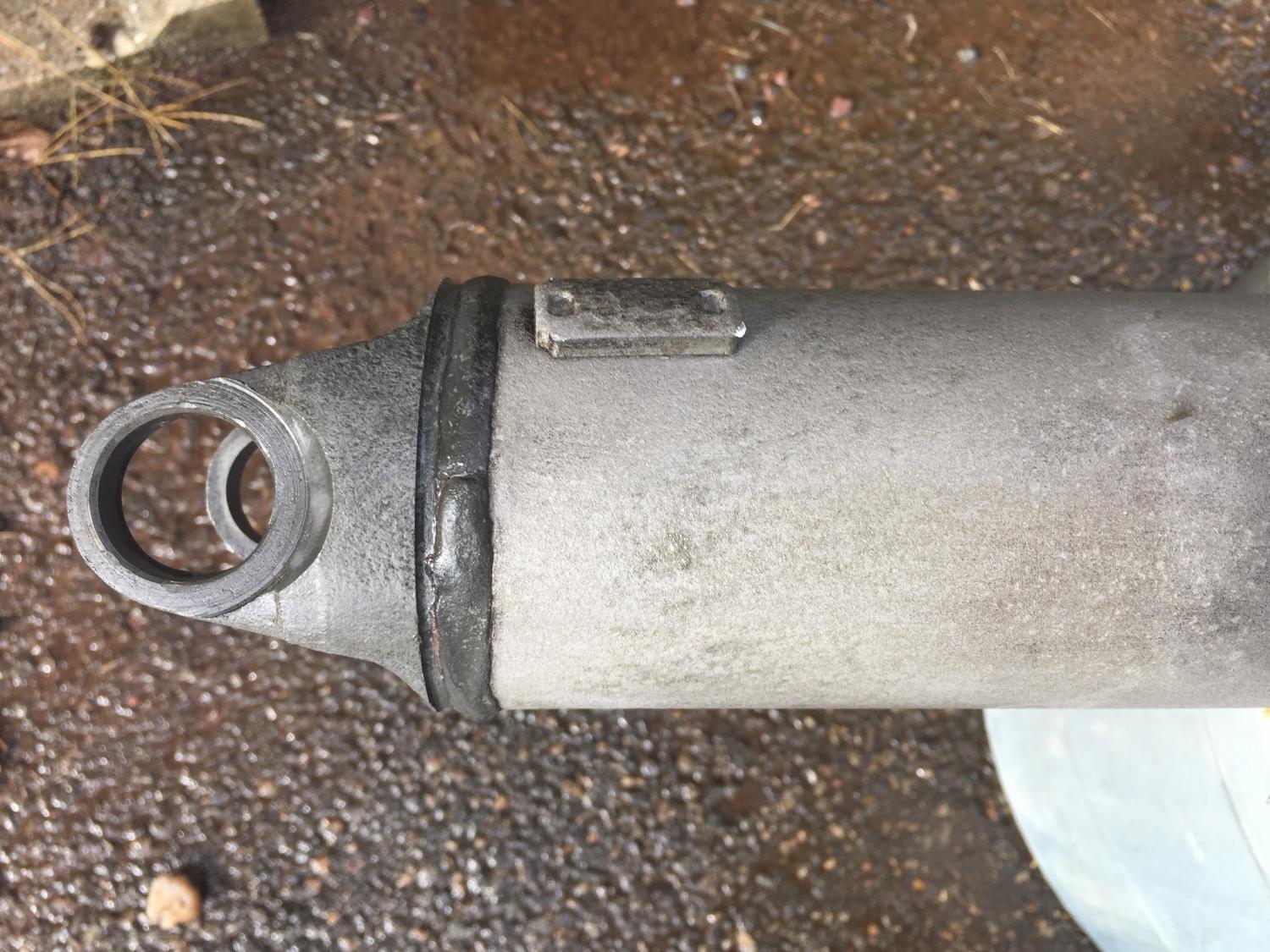

Originally Posted by rlw68 View Post
The original paint marks on the driveshaft might remain unless its soaked too long. I'd check it after 10 hours or so. More than 24 hours will likely dissolve them away. Lots of variables and luck involved here.
These are one trick ponies. I'm not sure what to do with it now??
Attachment 175165
Agree
