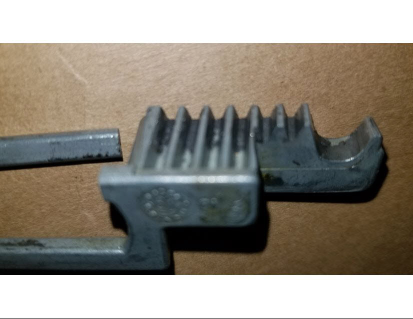

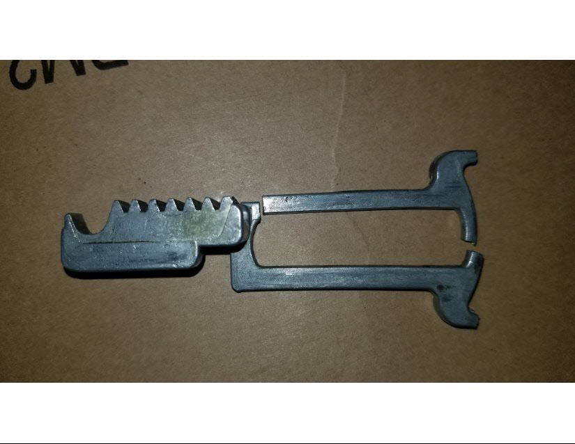

Default 1974 trans am rack steering column housing switch actuator
I Found the Rack on my tilt steering column is broken see attach pics he thing is the rack has 7 teeth and the sector (plastic gear between key cylinder and rack) have 6 teeth
need help to find the rack with 7 teeh and how i can installed thanks

thanks i have the book but illustration its no so good and the 7 teeth rack its not on Ebay do you have any idea where to find?

Most of the major parts houses have the rack. We use to fix a bunch of these. ed

It might be able to be tig welded.

amazon.com/Dorman-83221-HELP-Rack-Sector
Or maybe 83211.

That's a common part to break on a GM tilt column. Made a good amount of money repairing tilt GM tilt columns over the years. Call this guy, I've done business with him for years and he's got everything to do with Column parts and complete units, and knows them front to back.
Steering Column Services and Parts
https://www.steeringcolumnservices.com/

Thanks to all i found the correct Rack and installed lubricated and all go perfect
2 things i learn
the tilt steering column many people when live car push the tilt lever and the steering wheel go up abruptly but i recommended hold the steering wheel when you tilt up because the system is to strong and may have one reason the rack going broken,
the second is the buzzer when you inserted the ignition key sometimes works sometimes not is nothing wrong with the buzzer switch inside the steering column is your key the tip is rounded and may not work properly i try with brand new key and always works. thanks again
