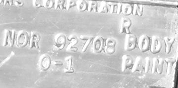

Looks like this may be a real festival car. Will need everything as the car appears to have lost its idenity. Good clues are there however. The patch of blue paint on the corner of the steering wheel, the blue seat belts, Vin tag and trim tag look correct and it has the early style traction bar. I wonder if the Pace car registry Mike R. has the vin recorded? My lists would show this vin to be in the ball park for production as listed by the seller. Charlie have a look...
http://cgi.ebay.com/ebaymotors/ws/eBayIS...p;category=6161
Attachments - The Supercar Registry 113786-vin_7N191975_pacecar.jpg 113586-Cnv0551.jpg

Most of the 396 Festival Pace cars are 325hp except for the very few 375hp cars. No 350hp. There were very few BB Festival Pace Cars made so this car has brought up a lot of interest.
But there are some big issues with the car.
I talked to the owner of this car on the phone and we talked quite a bit about it. One of the issues I had was the trunk pan.
If you look in the trunk, besides being patched, it has a 1968/69 trunk pan, shock towers and rear seat support. Totally incorrect for 1967. In this configuration that would mean the shocks are staggered which is also incorrect for 1967. He said he never realized the difference.
He informed me the original engine is also missing. The quarters and wheelhouses had been replaced at sometime and from the looks of it, the trunk pan. Unfortunately with the incorrect parts.
It has standard seats instead of deluxe.
The numbers add up to be a true Pace Car but there is no paperwork with the car.
He's not selling it cheap and it would cost a pretty penny to make it correct again.
Rick H.

Well if you dismiss a trim tag swap then the car is what it is. With festival cars documentation is almost non existant. The trim tag and Vin tag will verify IP track usage in this instance as the tag bears 0-1 and has the special stripe dash.
In reguard to your comments concerning the car being pieced together - I recall simular talk about the relative value in restoring Yenko and 69 COPO Camaro's as recent as 8 to 10 years ago that were also discovered "pieced together". I guess time will tell- or in the instance of this particular car - the bidders will speak in a final manner in about a week, and as of now they are bidding $27K.
